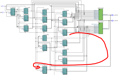

1. Do I understand correctly that setting the minimum and maximum delay constraints is necessary only for asynchronous combinatorial logic? Whether it is necessary to set, apart from the clocks constraints, the delay constraints for the synchronous register-comb logic-register case (fig 1), like set_max_delay -from [get_registers {x_1_3*}] -to [get_registers x_2_1d*] X ns?

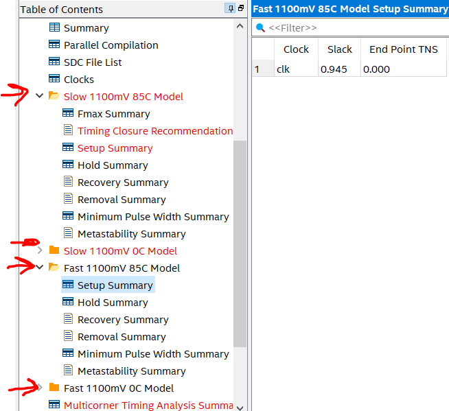

3. Another question concerns fast and slow models in Quartus. If the time constraints are met for the fast model, but not for the slow model (fig 2), what should I do to make the crystal work in the fast mode?
