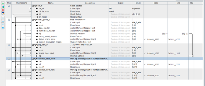

My QSYS project looks like below - if you want me to attach a QAR of my project I can do that as well.

Hello, just posting again - I tried doing a couple of things, but I still cannot understand why it does not work. I can certainly see transactions on the waveform, so the NiosII is doing something. But no idea at all why it is not getting to the print statement.

Can you try to connect the Nios data and instruction bus to on chip RAM.
