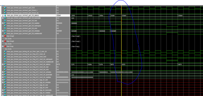

Now the strange part is that the address mapping seems to indicate only addresses from 0x0 -> 0x1f_ffff are supposed to go to the "reg_intf_sys_0" but when I ran a simulation I see this:
I can see the d_address (the data master address) performing a read at address 0x203de0, but it seems to be accessing the reg_intf_sys_0. I'm just a bit confused about why it's accessing this address space. I don't have any code on the NIOS2 that accesses this region, I have attached the "hello.c" file that I am running on the NIOS2. The address mapping seems strange, so I wanted to ask about it.

Can you connect the data and instruction bus of Nios to an on-chip RAM.
