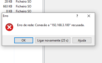

But when im try connect from WinSCP to the board, i have the error:
Network Error: Connection Recused.
What im can do guys?
First image show error(portuguese language, sorry)

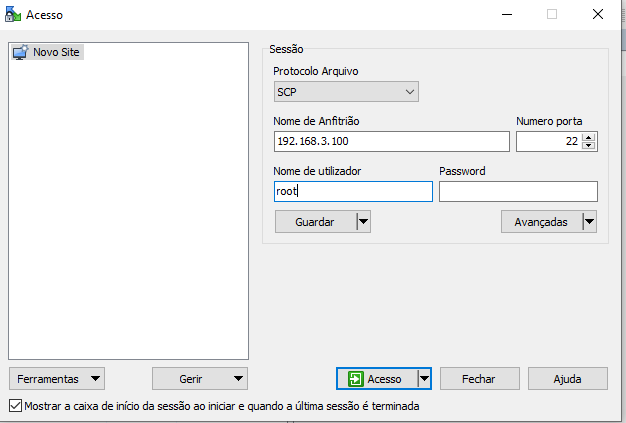

Secound error show configuration in WSP

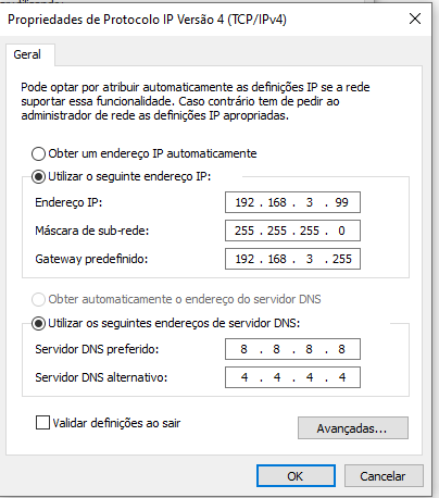

Third image show my computer config network.

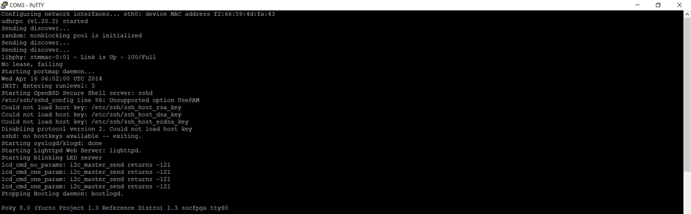

- SPere43
When i inicialize the board, i have this problem.
