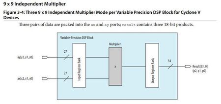

7 years agoHow to configure DSP block in "three 9x9 multipliers" mode?
Hi everyone Please help me configure DSP block in "three 9x9 multipliers" mode. I have a Cyclone V family chip, I've read this document https://www.intel.com/content/dam/www/programmable/us/en/pdfs/...
