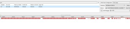

Hi, I am trying to read a continuous clock signal (125MHz) via IO pin (Bank 8A ,Pin no: L8 ,Pin Name: IO_8A_L8/CLK8P,FPLL_TL_FBP/DIFFIO_RX_T57P) on my custom made cyclone v fpga board. FPGA : Cyc...

6 years agoNow also the signal tap analyser is showing the discontinuity -- This may be due to the board issue. may be signal integrity issue .
