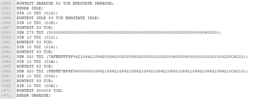

    I am using jtag to program EPM7128S (not JAM Player)
    I converted the pof file into an SVF file. Svf file describes the chip burning process and jtag instructions
    RUNTEST 53 TCK;
    SDR 320 TDI (FFE40D7F5AFFFFFFFFFFFFFFFD7FDFF7F5FD7FDF947FAFFFDFFFBFFD7FFF0001EC7E7EC7E40B4A56);
    SIR 10 TDI (01A);
    RUNTEST 53 TCK;
    SDR 320 TDI (FFBEEF7F5F96BF7D4A5A97FFFFFFFFFFFFFFFFFFFFFFFFFFFFFFFFFFFFFFD7BFFFFFFFFFFFFFFFFF);
    The data sent by the SDR 320 TDI is the pof data content.

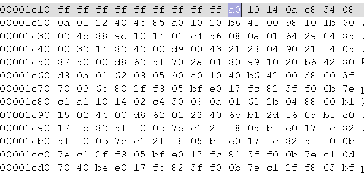

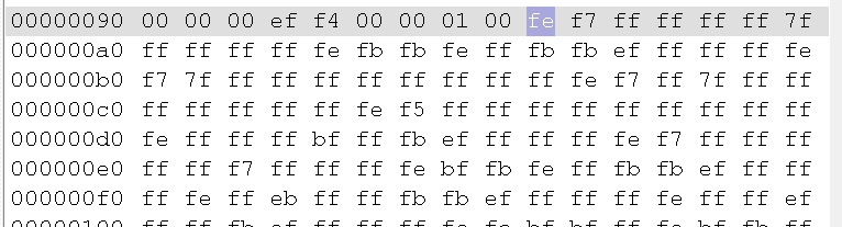

    I know how the data in the first half of the pof file is converted to SDR 320 TDI.
    But I don't know how to convert the second half.
    I also don't know how to verify chip.
    The screenshot of the second half is as follows:
    My question: EPM7128S programming process
    1. How to convert pof data into SDR 320 in svf file
    2. How to verify the chip after programming

    Hi WolfGang,
    I know how to use the Quartus Programmer to convert a POF into an SVF file and verify chip.
    However, I want to support this chip in my own programmer.
    Converting to SVF files is just to understand the chip programming process.(The second half of the svf file programming and the "verify" part did not understand)
    I want to know how to convert the contents of a POF file into the corresponding data of a JTAG instruction. That is how to write the POF file into the chip through JTAG and verify?
