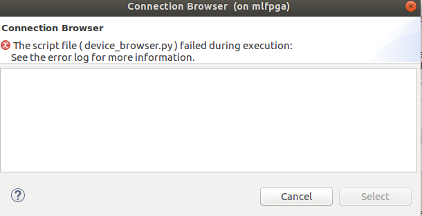

Debug server failing with "The script file ( device_browser.py ) failed during execution: See the error log for more information."

Everything is going well but when I am trying to run debug configuration(debug_server) it fails with errror "The script file ( device_browser.py ) failed during execution: See the error log for more information." It is not able to find the JTAG connection (USB Blaster II). If I run the
"./jtagconfig" command I am able to find the JTAG.
I have attached screenshot.
I would be really grateful if anyone can help me with this error.

    Is this error pops up after you did the following?:
    • Select target to be Altera > Cyclone V SoC (Dual Core) > Bare Metal Debug > Debug Cortex-A9_0 and Target Connection to be USB-Blaster.
    • Click the Connection > Browse Button to select the connection to the target board.
    Possible solution: Before running eclipse, you must set the system variables QUARTUS_ROOTDIR and LD_LIBRARY_PATH.
    Let me know if you need more help.
    Regards.
