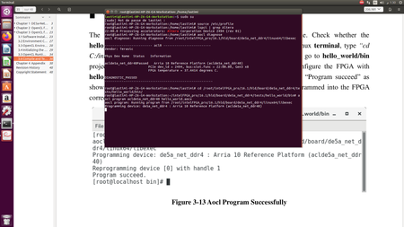

Hello, I am using De5a_net Arria10 GX. I have the license and all SDK and BSP are installed, also, all guide steps are completed successfully, the "flash aocl", "install aocl", "aocl diagnose", but a...

I solve this problem by changing Ubuntu 16 to Centos 7.5, and now it works fine.
