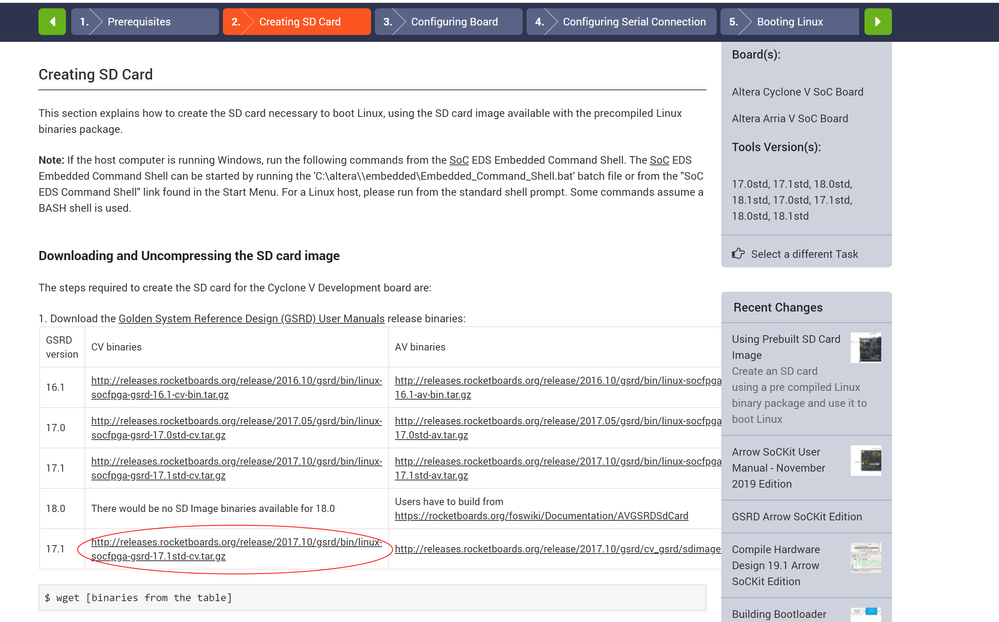

We also tried the image from http://releases.rocketboards.org/release/2017.10/gsrd/bin/linux-socfpga-gsrd-17.1std-cv.tar.gz, but got the same issues.

Thanks. The image https://releases.rocketboards.org/release/2019.10/gsrd/cv_gsrd/ works
This page is misleading
https://rocketboards.org/foswiki/Documentation/GSRDBootLinuxSd

Thanks for pointing out the correct link. May I know, does this solve your issue?
- Shengquan_Y_Intel
Yes. The issue is solved.
