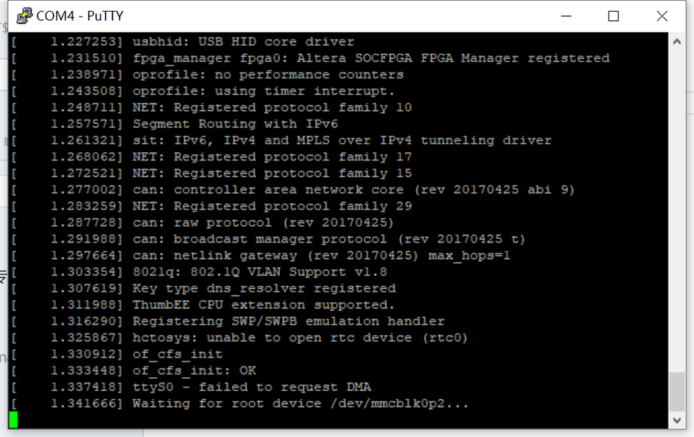

Add an UART(RS-232 Serial Port) IP to the DE10-Nano GHRD project, the system stucked!
Add an UART(RS-232 Serial Port) IP to the DE10-Nano GHRD project, update the rbf and dtb file, the system stucked with error: Waiting for root device /dev/mmcblk0p2...
1 Reply
  • EricMunYew_C_Intel's avatar
    EricMunYew_C_Intel
    can you try to prepare your FAT partition and rewrite your rootfs into sdcard.
