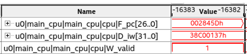

For example,
a1174: 38c00137 ldwio    r3,4(r7)
  • *|cpu|F_pc[26:0] to 0x2845D
  • *|cpu|D_iw[31:0] to 0x38c00137
  • *|cpu|W_valid
