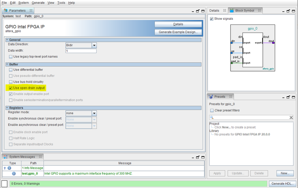

    (ii) Another way is to use GPIO Intel FPGA IP. You can enable open-drain for SCL and SDA, connect both OE ports for SCL and SDA to 1 (high), and connect the inverted signals of the original OE control signals. In this way, you can work around the constraint. Following is an example:
          gpioip gpioip_scl (
                      .dout   (i2c_serial_scl_in),
                      .din    (~i2c_serial_scl_oe),
                      .oe    (1'b1),
                      .pad_io (arduino_adc_scl)
          gpioip gpioip_sda (
                      .dout   (i2c_serial_sda_in),
                      .din    (~i2c_serial_sda_oe),
                      .oe     (1'b1),
                      .pad_io (arduino_adc_sda)
