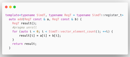

SIMD abstraction libraries are an obvious choice to incorporate SIMD processing capabilities for FPGAs. As mentioned, those libraries typically support typical SIMD instruction set extensions from Intel and ARM processors. The following example shows how SIMD instructions are easily implemented on an FPGA using the TSL abstraction library. In the general example of element-wise addition shown below, the scalar code describes the functionality of loading registers, and the pragma unroll attribute informs the DPC++ Compiler to implement all paths in parallel.
In this simple element-wise example, there are no dependencies between the instructions, and similar implementations will work for other SIMD instructions, such as scatter, gather, and store. Complex instructions can also be optimally accelerated.

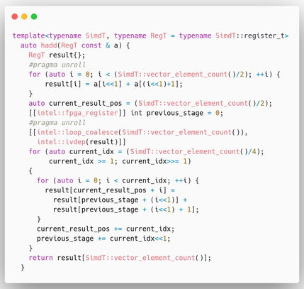

A horizontal reduction requires an adder tree of depth ld(N) where N is the number of elements and is only provided at compile time. The following code example shows how this can be implemented in a scalable manner using an unroll pragma with a compile-time constant to implement the adder trees. In the following examples, the loops are unrolled in hardware optimally by ld(RegisterSize/sizeof(DataType)) = ld(SIMDElementCount).

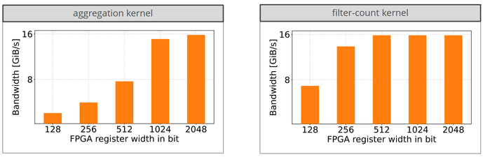

First, they examined the impact of the register width on the maximum acceleration bandwidth by progressively increasing the register width of the SIMD instance. In the first case, a simple aggregation, their result showed that the bandwidth of the FPGA accelerator increases with each doubling of the data width until the global bandwidth saturates—an ideal acceleration case.
In the second case, a filter-count kernel, which has a data dependency in the last stage of the adder tree, similar behavior was seen, but this case saturates earlier, at the width of the PCIe link. Both cases highlight the expected benefits of natively parallel instructions executing on a highly parallel architecture - impressive acceleration gains - and indicate that the benefits achieved could be continued with wide memory accesses.

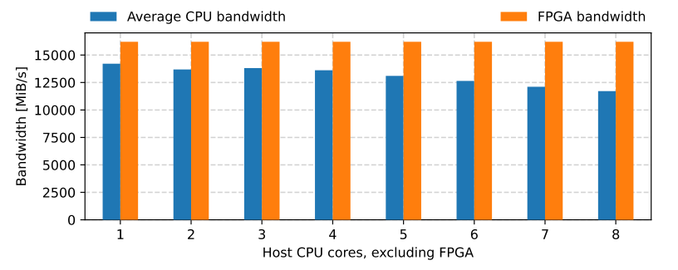

A final performance comparison was done comparing the FPGA to the CPU. The same multi-threaded AVX512-based filter-count kernel was dispatched onto the CPU and FPGA. As more concurrently working threads were added and the number of CPU cores increased, the per-core CPU bandwidth degraded, as expected. The FPGA maintained peak performance across the entire range of the workload.
