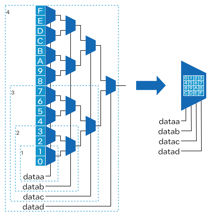

To begin, let’s look at the structure of a generic n-input lookup table. A lookup table is a sequence of multiplexers that select a specific storage location based on the inputs, just like a 1-bit memory. The number of storage locations required is 2 raised to the power of the number of inputs, again like a memory with n address pins. Below is an example of a 4-input LUT, with the smaller LUTs indicated by dashed bounding boxes. We will use the simplified representation of the 4-input LUT through the rest of this article.
Figure 1 n-Input LUT

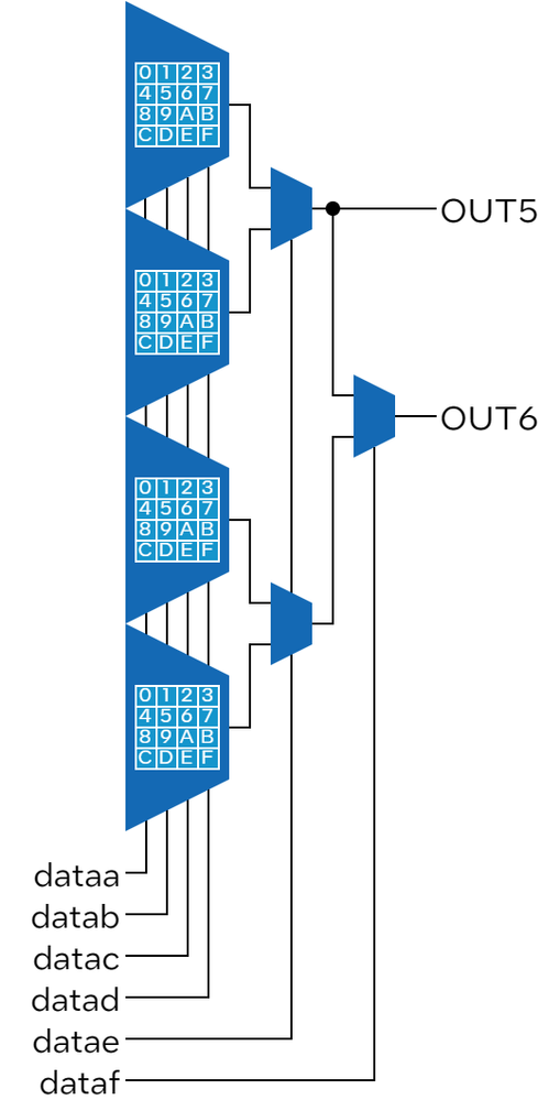

Adding inputs increases the complexity of the logic that can be implemented, but each input bit that is added doubles the number of storage bits and multiplexers required. These extra resources will be wasted when implementing simpler logic. One way to minimize the wasted bits is to provide taps to the intermediate multiplexers. An example of a 6-input LUT with dual 5-input LUT outputs is shown below. This simple approach can allow the implementation of two 5-input LUTs, but it has the restriction that both LUTs are controlled by the same 5 inputs.
Figure 2 Basic 6-Input LUT

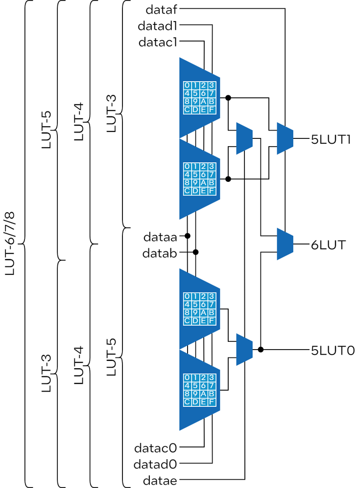

Intel Agilex FPGAs take a different approach that allows for greater device utilization. As shown in the diagram below, Agilex FPGAs have a novel 6-input LUT structure with 8 inputs called Adaptive Logic Module(ALM) . Some of the inputs to the smaller LUTs are separated to allow for additional flexibility. With the additional inputs it is possible to mix smaller logic functions dependent on different signals. Some of the different LUT combinations are shown in the diagram below.
Figure 3 Agilex FPGA ALM
When datac0 and datad0 are tied to the same signals as datac1 and datad1 respectively, this block implements a traditional 6-input LUT, but there are some 7 and 8 input logic functions that can be implemented by using them separately. These additional 7 and 8 input configurations, plus all the 3, 4 and 5 input LUT configurations make this implementation much more flexible and allow for greater device utilization.
