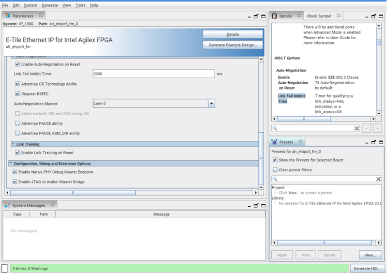

For designs with AN/LT:
1. Change Link Fall Inhibit Time value in the IP parameter to 2000 as shown in the following screenshot:
2. Click Generate HDL.
3. Make the changes to <example_design_variation_name>\example_testbench\basic_avl_tb_top.sv as decribed above.
