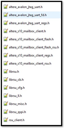

  4. Observe that both folder directories are the same – inc and src
  5. Copy the contents of Quartus® Prime HAL folders into the BSP drivers folders, respectively.
  6. Navigate to <Quartus Prime directory>/24.1/ip/altera/pgm/altera_s10_mailbox_client/inc.
  7. Copy altera_s10_mailbox_client_regs.h into the BSP drivers/inc folder.
  8. Verify the content of the BSP inc folder is as below.
