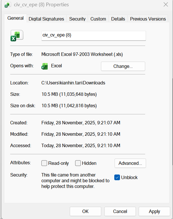

1. Unblock the Excel File
• Right-click the EPE Excel file → Properties → Check Unblock under Security.
• Click Apply → OK.

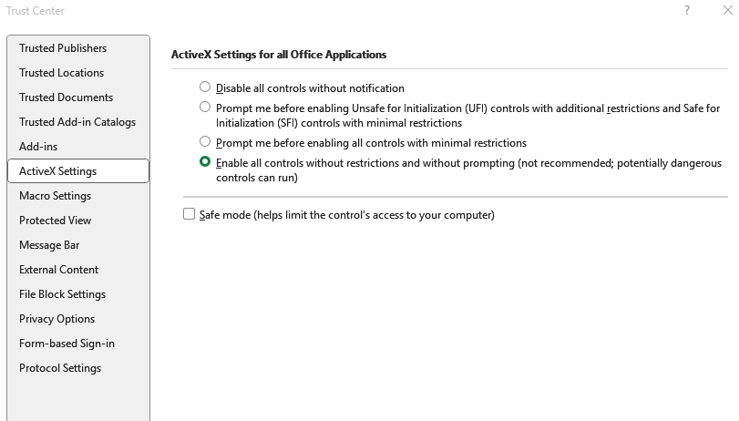

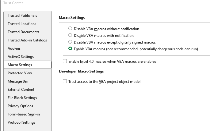

2. Enable Macros and ActiveX
• Open Excel → File → Options → Trust Center → Trust Center Settings:
Enable Macros.
Enable ActiveX controls.
Leave other settings as default (Safe Mode can remain enabled or disabled).

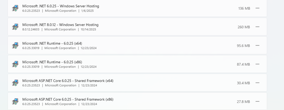

Microsoft .NET installation
Go to your Installed apps settings and find for .NET. It is recommended to have both .NET Runtime and ASP .NET installed in your system. If you already have a version installed on your machine then proceed to the next step( you only require 1 version each), otherwise refer to this location to download Download .NET 8.0 (Linux, macOS, and Windows) | .NET
Example:

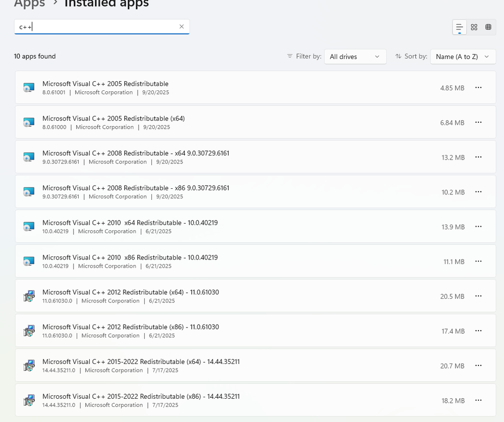

Microsoft Visual C++ Installation
As different EPE Excel sheet relies on specific Visual C++ version, you will need to install multiple versions of Visual C++ for both 32bit and 64bit. This is because even though Excel is running on 64bit, existing scripting might have dependency on 32bit functions as well.
Recommendation to install C++ version for both 32 bit and 64 bit as below Latest Supported Visual C++ Redistributable Downloads
  • Visual Studio 2017-2026
  • Visual Studio 2015 (in older Microsoft release, it might show as C++ V14 or 2015-2022 version)
  • Visual Studio 2013
  • Visual Studio 2012
Example
After installing both 32 bit and 64 bit, do restart the system and then try launching the EPE excel sheet again.
In some rare occurrences, you might need to install Visual Studio C++ 2010 , Visual Studio C++ 2008 and Visual Studio C++ 2005. Do refer to PART C first as the issue might not be due to Visual C++ but symbolic link.

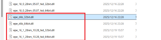

If installing the .NET and Visual C++ runtime libraries still does not help in resolving the error opening EPE Excel, you should check whether your %TEMP% file folder is the same as what reported in the error when opening the EPE excel sheet. If the folder path are different between %TEMP% and the path reported by Excel sheet, it means that they are using symbolic link folder. In this case user should copy the .dll files generated out from the %TEMP% when they opened the excel sheet and copy it over to the Windows SySWoW folder (%windir%\SysWOW64).
To access your %TEMP% folder , just type %TEMP% into your explorer and it will open your folder location (%TEMP% is set in windows environment variables)
From the %TEMP% folder, there are multiple *epe* DLL files if you open different EPE excel sheets. Copy all of these .DLL files into your Windows SysWOW64 folder and try launching the EPE excel sheet again.
Example, if using Cyclone® V EPE excel sheet, these are the 4 files required in red box in %TEMP% to be copied over

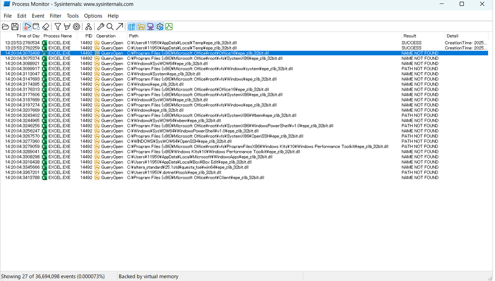

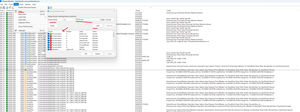

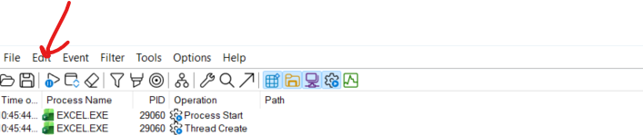

If all fails, alternatively install Process Monitor from Microsoft to analyze the DLL failure/error
1. Download Process Monitor from this location Process Monitor - Sysinternals
2. Close all excel sheets that is open in Windows.
3. Launch the Process Monitor , then select Filter. Set to Process Name and EXCEL.exe and click Add.
4. After adding the filter, ensure that capturing is started

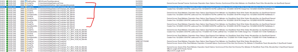

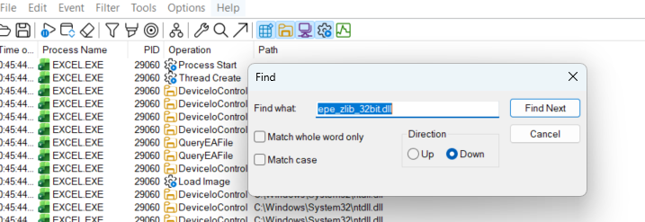

5. Then open any of the EPE excel file,and wait till you get the DLL (eg. epe_zlib_32bit.dll) error then press pause on the Process Monitor.
6. Then use Find and search for the dll error stated in the excel(eg. epe_zlib_32bit.dll)
It will give you a list of things, but important is to check the details on createfile, open, close , query, those are the functions that are in the zlib dll file.
Example
Good case scenario where no error occurred.
Fail case scenario where Windows unable to locate the DLL (due to symbolic link issue)
