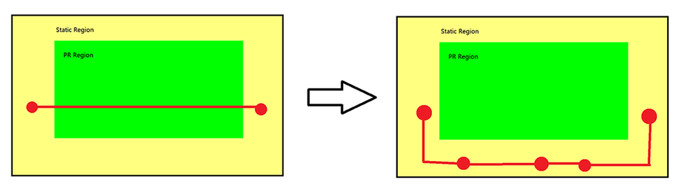

  3. For the remaining signals:
    • Add enough pipelining registers.
    • Create a floor plan for the interconnection logic crossing PR region so that it runs along the PR region boundary like a channel.
