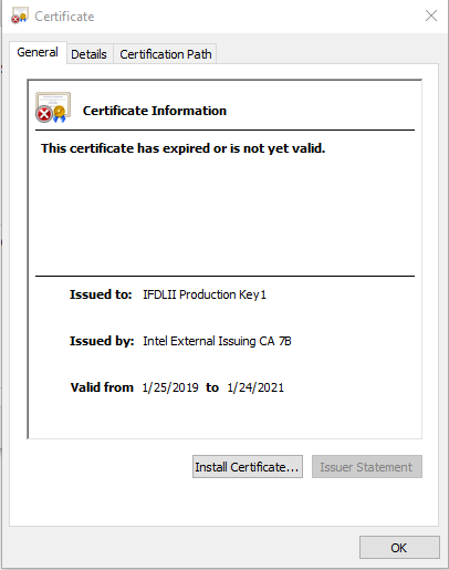

Follow the next steps to verify if the digital signature certificate of your driver has expired:
  1. Go to '<Quartus Installation Path>\qprogrammer\quartus\drivers\usb-blaster-ii' folder
  2. Right click on 'usbblasterii.cat' and select 'Properties', then select the 'Digital Signatures' tab
  3. Select the 'IFDLII Production Key1' signature from the 'Signature List' and click 'Details'
  4. Click on 'View Certificate'
  5. If the driver has expired, you will see the 'This certificate has expired or is not yet valid' message
