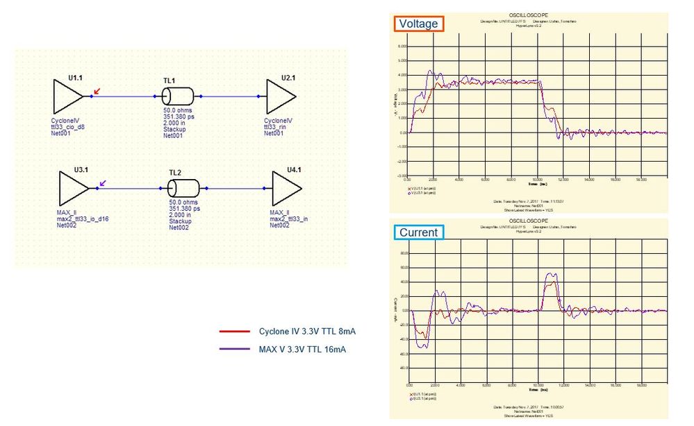

If you want to check whether the AC output current you observed is normal, you can use the IBIS simulation result to see the expected behavior of the output current compared to the actual measured results.
Resolution
The below figures are example results of IBIS simulation with 3.3V TTL outputs of Cyclone® IV and MAX® II.
