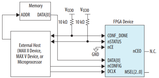

Is there a known problem with the DATA[0] connection shown in the block diagrams for Passive Serial Configuration in the Intel® Cyclone® 10 LP Core Fabric and General Purpose I/Os Handbook?
Description
Yes, in Intel® Cyclone® 10 LP Core Fabric and General Purpose I/Os Handbook version 2020.05.21 and earlier, there is a problem with the DATA[0] connection in the block diagram available in Chapter 6.1.2, Figures 88, 89 and 90. These diagrams incorrectly show a direct connection for DATA[0] between the Intel® Cyclone® 10 LP FPGA and Memory device.

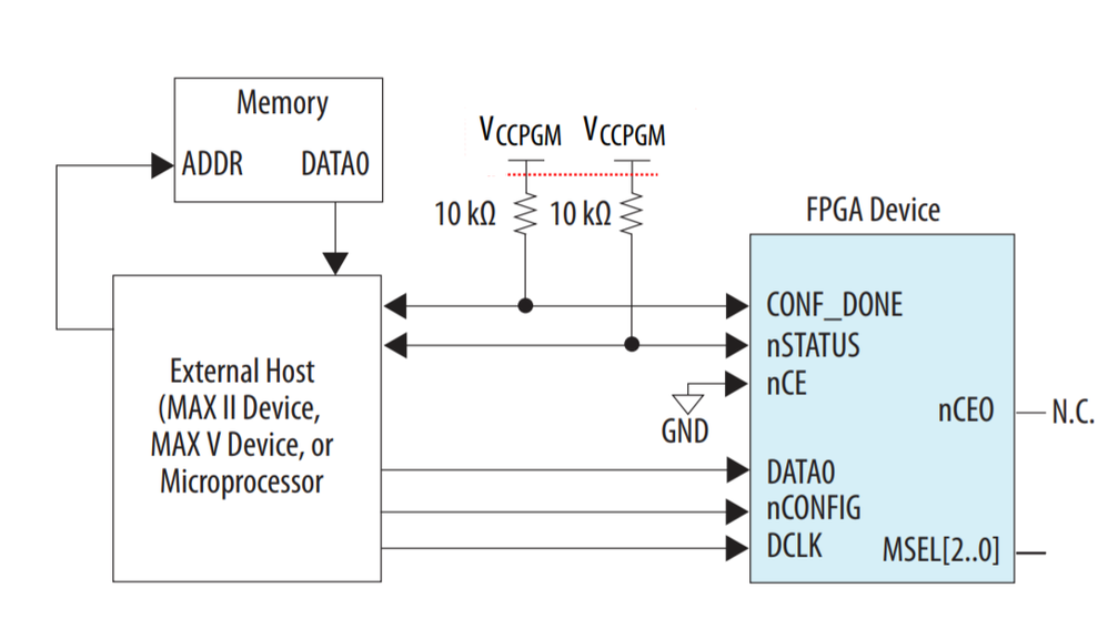

The DATA[0] pin should be connecting to the external host, such as a CPLD or microprocessor, as shown below.
This is scheduled to be fixed in future release of the Intel® Cyclone® 10 LP Core Fabric and General Purpose I/Os Handbook
