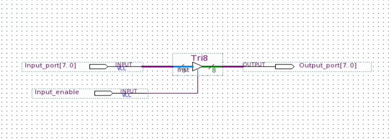

Due to a problem in the Intel® Quartus® Prime Pro Edition software version 19.3 and earlier, you may see the above internal error when you use different port type in the Top level block design (.bdf) file and the HDL (.v/.vhd) file.
For example,
In HDL file, tridata is declared as of type OUTPUT
entity Tri8 is
port(
    <Input_enable> :in std_logic;
    <Input_port> :in std_logic_vector(7 downto 0);
    <Output_data> :out std_logic_vector(7 downto 0)
end Tri8;
Whereas in .bdf file, the tridata is used as type BIDIR.
Resolution
To work around this problem, fix the design so that both the HDL file and the .bdf file have the same port type for port specified.
This problem is fixed beginning with the Intel® Quartus® Prime Pro Edition software version 19.4
