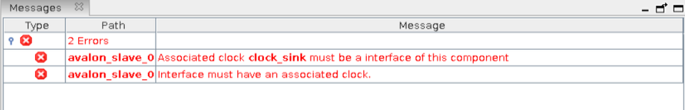

Errors: Associated clock clock_sink must be a interface of this component.
Description
Due to a problem in the Intel® Quartus® Prime Pro Edition software version 19.4 and earlier, you may see errors below even though you have assigned an associated clock to the Avalon® Memory Mapped interface when creating the component using the component editor tool.
