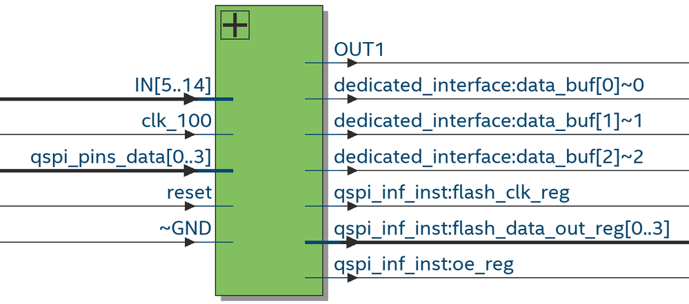

Generic Serial Flash Interface FPGA IP (viewed in Technology Map Viewer)
OE signalsExported Conduits
dedicated_interface:data_buf[0]~0qspi_pins_data[0]
dedicated_interface:data_buf[1]~1qspi_pins_data[1]
dedicated_interface:data_buf[2]~2qspi_pins_data[2]
qspi_pins_data[3]
qspi_inf_inst:oe_regqspi_pins_dclk
qspi_pins_ncs
