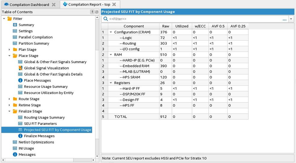

Yes, the Intel® Quartus® Prime Pro Edition Software can enable the SEU FIT Reports using the same assignment as Intel® Quartus® Prime Standard Edition.
Refer to 1.6.3. Enabling the Projected SEU FIT by Component Usage Report in AN 866: Mitigating and Debugging Single Event Upsets in Intel Quartus Prime Standard Edition for the required assignment.
After enabling the SEU FIT Reports, you can see the SEU FIT Parameters and Projected SEU FIT by Component Usage reports under the Finalize Stage of the Fitter in the Compilation Report.
