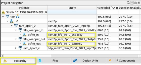

- Display the Hierarchy tab in the Project Navigator on the Quartus® Prime Pro Edition.
- Expand your design hierarchy and find the following instances under the emulated TDP RAM instance.
- ram_2port_0 > fifo_wrapper_in > dcfifo_in
- ram_2port_0 > fifo_wrapper_out > dcfifo_out - Remember the entity names of the dcfifo_in instance and the dcfifo_out instance.
In the following example figure, remember the entity names enclosed by the yellow square.
- "ram2p_fifo_1910_sno4eky" for the instance dcfifo_in
- "ram2p_fifo_1910_3zzux5y" for the instance dcfifo_out

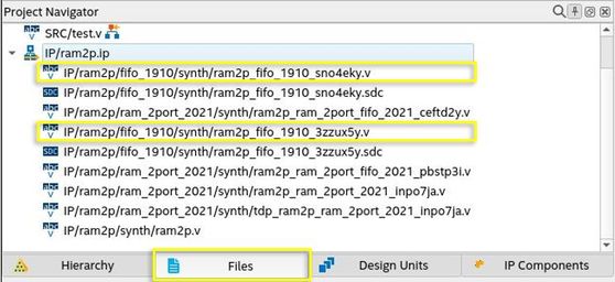

- Go to the Files tab of the Project Navigator.
- Expand the .ip file of the emulated TDP RAM and find <the entity name of the dcfifo_in>.v and <the entity name of the dcfifo_out>.v.
In the following example figure of the Files tab, the files enclosed by yellow square will be edited.

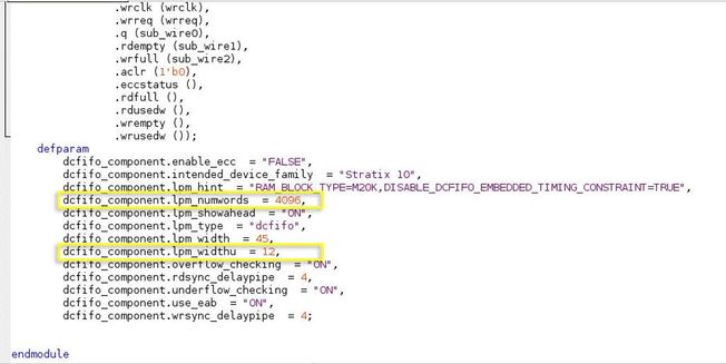

- Open <the entity name of the dcfifo_in>.v.
- Find the following parameters in the defparam declarations.
- dcfifo_component.lpm_numwords = <lpm_numwords number>
- dcfifo_component.lpm_widthu = <lpm_widthu number>
- Change dcfifo_component.lpm_numwords and dcfifo_component.lpm_widthu.
- dcfifo_component.lpm_numwords must be greater than the clock frequency ratio of clock B (fast clock) divided by clock A (slow clock) of the emulated TDP RAM IP
- dcfifo_component.lpm_numwords must be greater than 4
- dcfifo_component.lpm_numwords must be 2^dcfifo_component.lpm_widthu
For example,
- If the ratio of Clock B frequency/Clock A frequency is 5, the minimum dcfifo_component.lpm_numword must be 8 (2^3)
- If dcfifo_component.lpm_numword is 8 (2^3), dcfifo_component.lpm_widthu is 3 - Save the file
