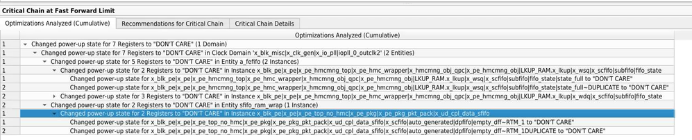

      I also see the fast forward compilation report as below:
      it still report the power-up state of the register in the scfifo. the fifo is quartus ip, I doesn't know to change  power-up state of the register to DON't care.
