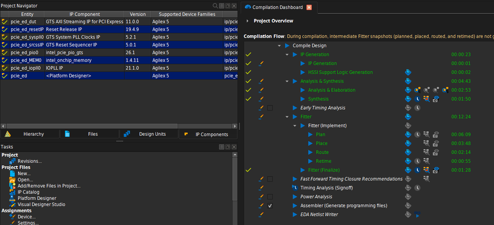

    • RichardT_altera's avatar
      RichardT_altera
      I tried compiling the provided design and was able to compile it successfully. I’m not sure if there are any specific environment details or variables that could be causing this behavior.
      For now, perhaps we can monitor the situation to see if other users encounter a similar issue, and revisit this if it affects a larger number of users.
      RichardT_altera
      At which compilation stage does the error occur? I was able to generate an example design and compile it successfully.
      Could you please share your design by archiving the project (Project > Archive Project) so I can reproduce the issue on my side?

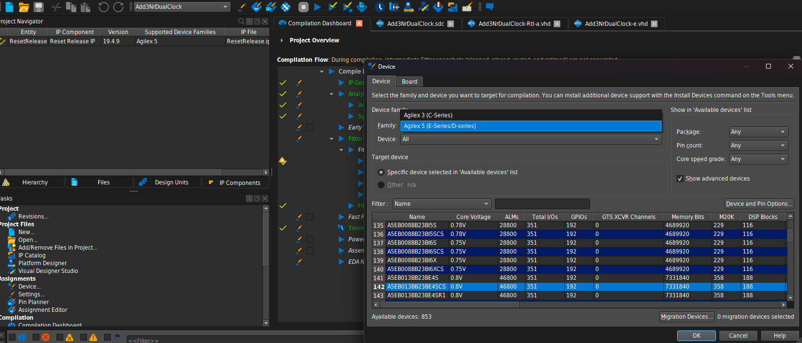

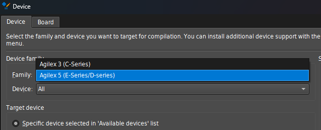

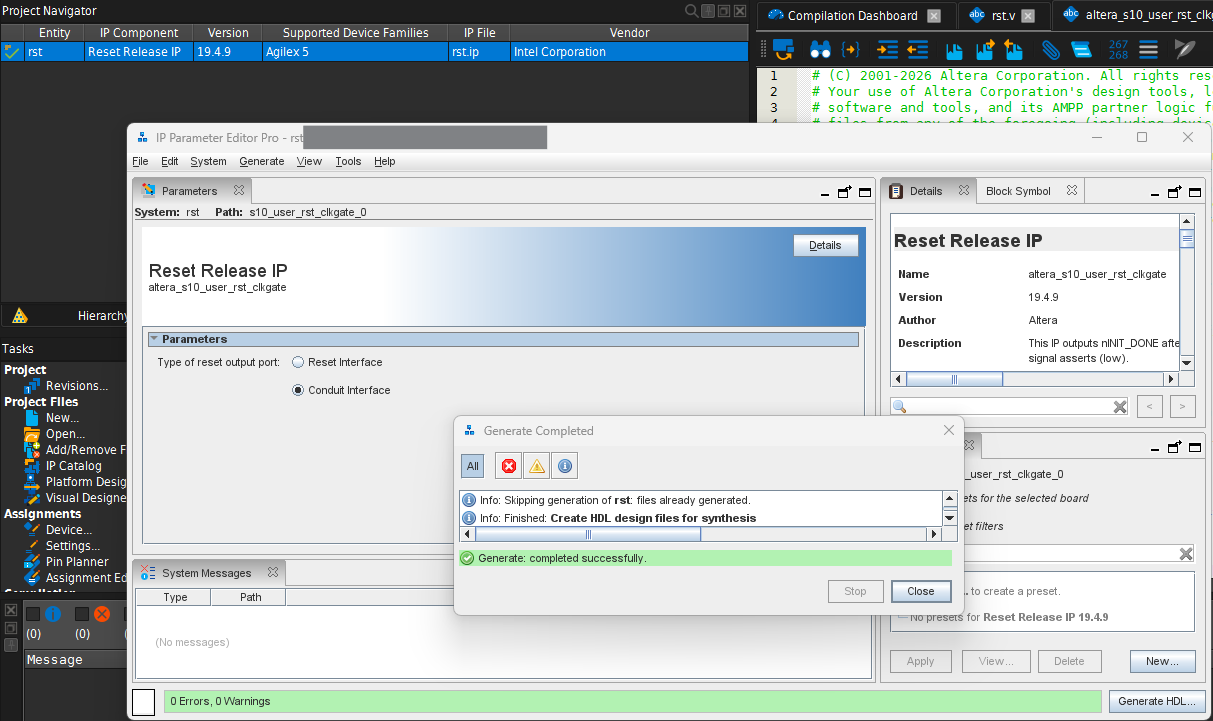

  • I’ve installed Quartus Pro 26.1 with Agilex 3 and Agilex 5 device only, and I’m able to instantiate the Reset Release IP successfully.
    Could you please share the error message or a screenshot showing the issue?
    Which OS are you using?
    Are you able to instantiate the Reset Release IP after installing the Stratix 10 (S10) devices?
    Richard Tan
