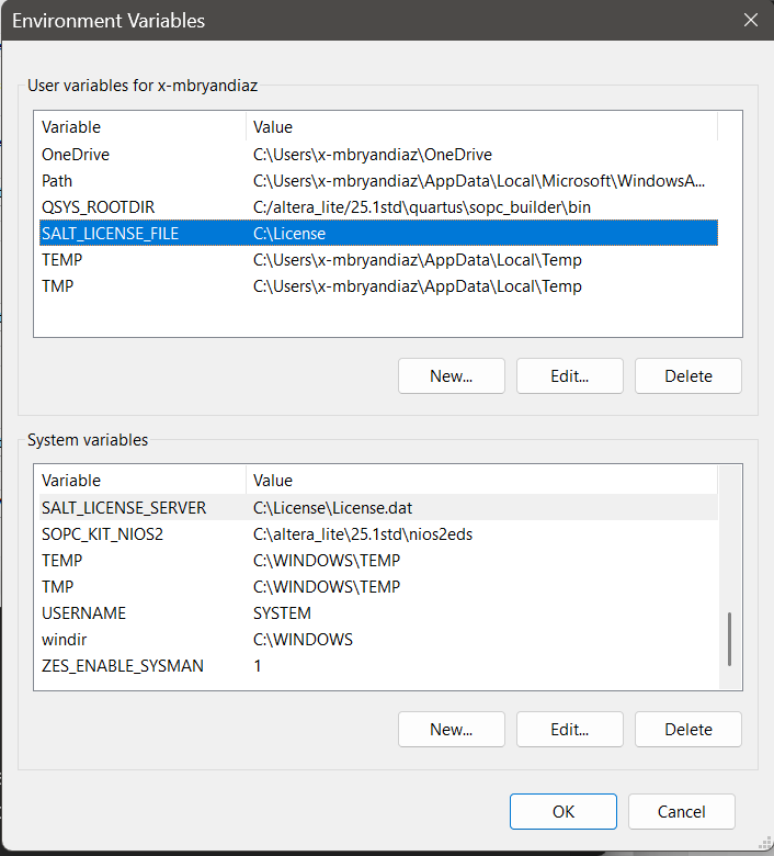

Is it a new file? Open and check the expiration date and the MAC address of the network interface you entered into the SSLC.
- mel0nhead702
I found out what was wrong. I was using the wrong NIC ID. It's working now thanks sstrell

Is it SALT_LICENSE_SERVER?
- mel0nhead702
Yes
