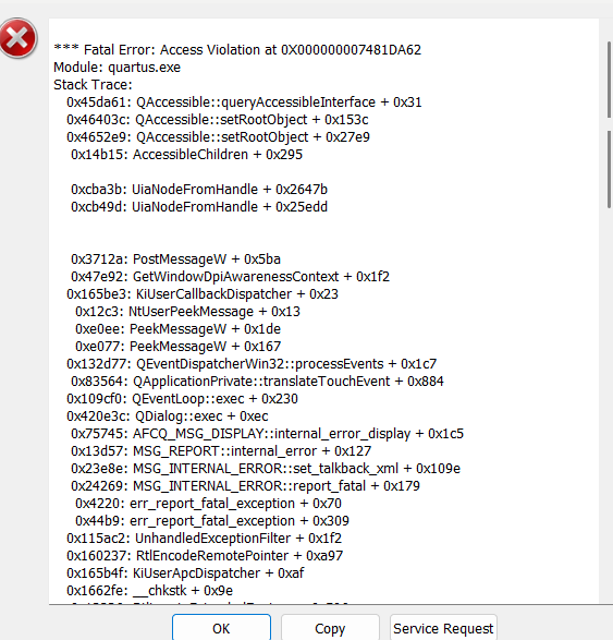

I’ve been having trouble compiling projects with Quartus Prime Pro version 25.1 for several days. In an unpredictable manner, Quartus stops the compilation or freezes at a certain point—it can happen at the beginning, during synthesis, when the fitter starts, or during timing analysis. I’ve carried out extensive testing. I’ve tried reinstalling the program several times, and it’s true that right after installation, several successful compilations can be achieved; however, after around the fifth one, it usually starts failing and won’t compile anymore. The message window during compilation doesn’t provide any details about the error. I’ve also tried installing the newest version, but it behaves similarly. After a few attempts, I noticed that at the exact moment of the crash, the program generates a file called serv_req_info.txt, which I’ve attached. I’ve formatted my computer and updated to the latest version of Windows, and even replaced the internal SSD, but nothing has solved the issue. I’d appreciate any help in finding the cause of the problem.

    Hello cblixt, thank you for your response. I’ve tried installing the patch, and it seems to have solved the issue—at least the two compilations I ran after installing it completed successfully, and no text file was generated. However, I don’t understand the origin of the problem or how it’s possible that it also affects such an old version of Quartus as 13.1, which I use for some older FPGAs. When I try to compile a project for those, a similar error appears, and the program closes.

        Hello, the FPGA I’m using is no longer supported (I assume) in the newer versions of Quartus—it’s an older Cyclone III. The design itself isn’t problematic, since it’s the same one I’ve been compiling for a long time, with only minor changes in each build. Moreover, the error occurs when opening the program, it doesn’t even need to reach the compilation stage. In any case, it seems that reinstalling the software and the previous system reformat have solved the issue.

      This is not the same problem. That problem affected only Quartus Prime Pro versions 23.3 - 25.3.1, that's why there are only patches available for those versions.
      If you have another problem happening in Quartus 13.1 I don't expect that to have suddenly appeared on Jan 10 like the above mentioned problem did, and I would recommend posting a new question for it with an adjusted title.
