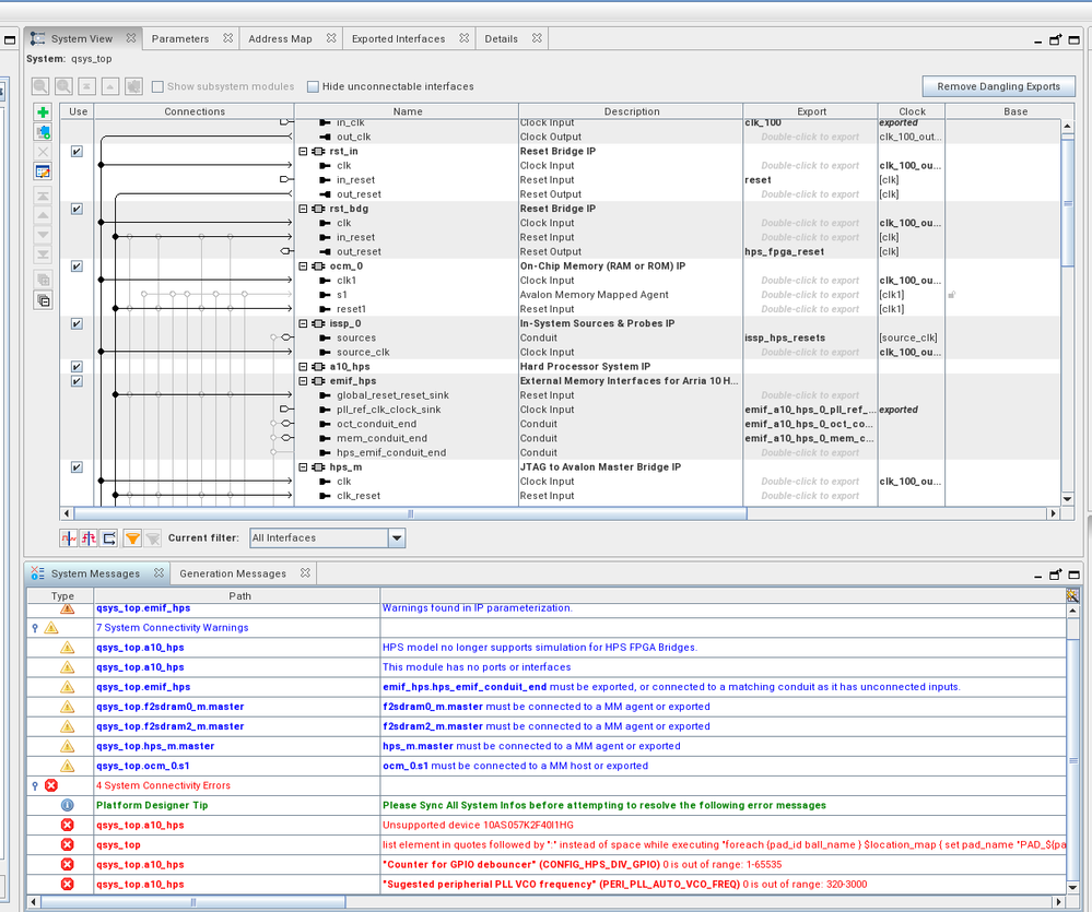

Issue
Chandu Sri is facing compilation errors in Quartus when working with the Arria 10 device (10AS057K2F40I1SG/10AS057K2F40I1HG) and HPS IP, both in Quartus Standard and Pro editions (20.1std, 24.1Std, 25.1.1pro).
  • Errors include unsupported device messages, out-of-range configuration values, and Tcl script issues when generating the HPS IP core.
  • The Arria 10 device is flagged as deprecated in the Standard version; IP core generation fails in Pro edition as well.
  • Example design generation is disabled for krpi_pcie.qsys; krpi_hps.qsys IP core creation fails with multiple errors.

  • Device was changed from 10AS057K2F40I1SG to 10AS057K2F40I1HG, but errors persist.
  • Attempted manual recreation of the IP cores in 25.1.1pro instead of upgrading legacy designs.
  • Provided .qar file and detailed error logs to Intel support for further analysis.
