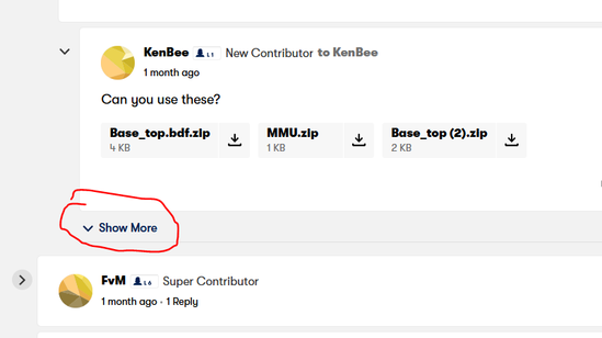

  • Regarding the issue where the “Show More” button never opens, as mentioned by FvM​ , you may try switching the display format to “Linear” as a workaround. This format will display all the responses.
    Richard Tan
  • FvM's avatar
    FvM
    Can't read todays new posts in the middle of this thread. "Show More" never opens
    Tried different web clients, is it a forum software bug?
