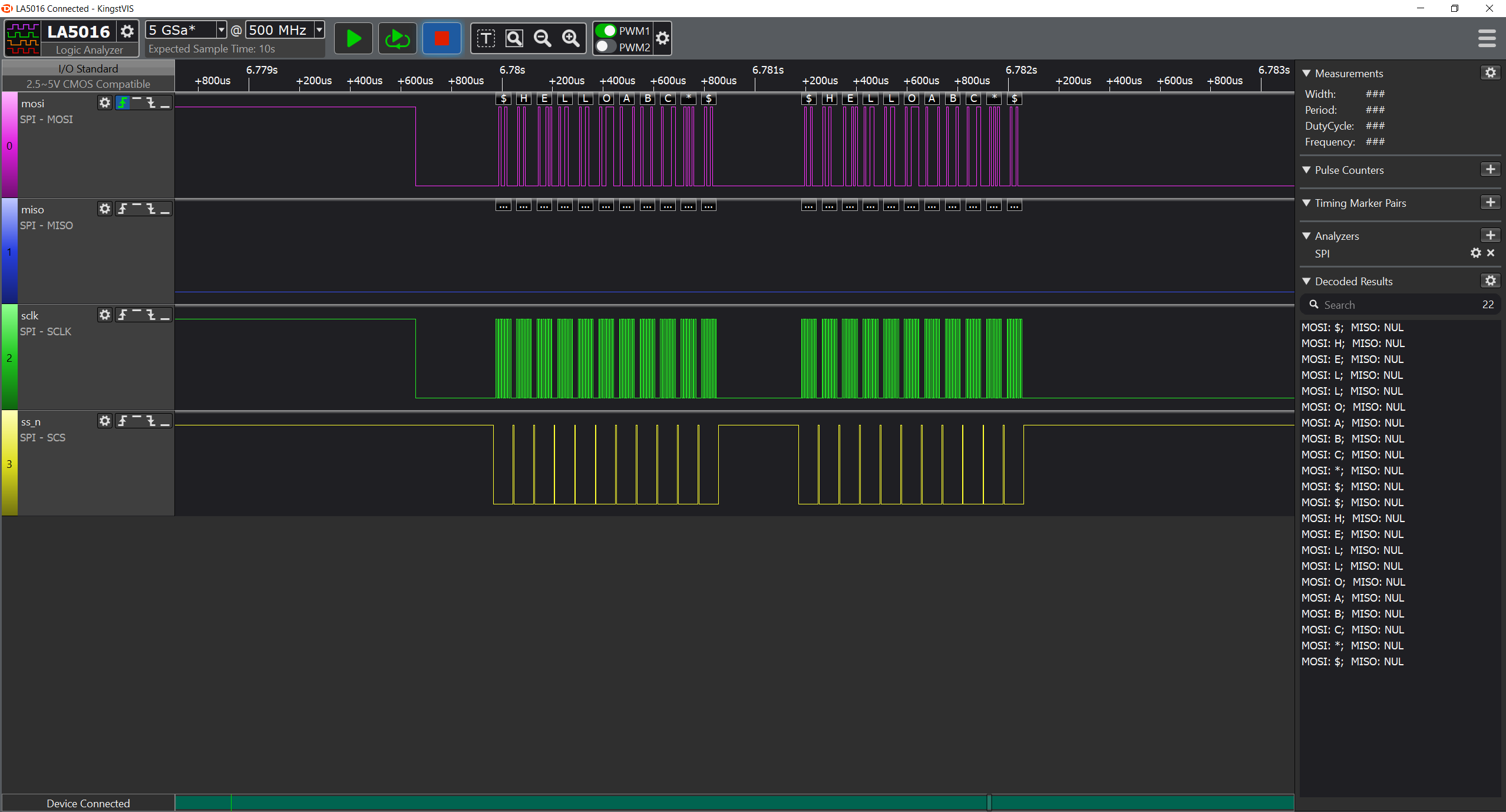

The problem comes when I try to generate the .hex file using "mem_init_generate" and compile the project in quartus to generate the .pof file. The .pof file that I loaded inside my FPGA is unable to send the "$HELLOABC*" continously. It only sends 2 "$HELLOABC*" and stops abruptly (as attached in spi_output.PNG )

Below attached is the hardware of my SPI program, Nios II Application Code and spi_output image from a external logic analyzer.

The problem has been resolved by disabling the alt_printf statement in my C code. My .pof works now, and it can send the spi commands after power cycling the board.
My guess is that as there is no communication between the board and the nios2 terminal, the alt_printf pointer got lost when executing the function. Hence when loading .pof, all alt_printf must be disabled.
