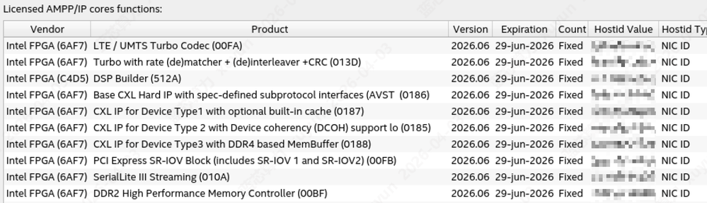

But in Tools -> License Setup,I can see feature "6AF7 0185" is valid.

  • Hi,
    Pls check followings:
    1. Don't mix several CXL licenses
    2. The license is for the Quartus version you're using
    3. Confirm lic path
    These two are not exactly the same. Pls check if your lic is valid for example design.
    Rong
