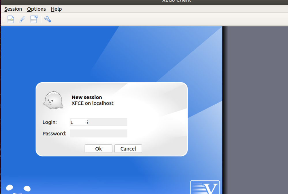

      But facing issue with GUI access with x2goclient. Please help me to fix this.
      Never setted password with devcloud account

  • JohnT_Altera's avatar
    JohnT_Altera
    Do you performed the step as below?
    1. Execute "devcloud_login"
    2. Select Arria 10 PAC or Stratix 10 PAC
    3. Open new terminal and execute "ssh -L 4002:s00x-n1xx:22 devcloud" depending on the node that you login
    4. Connect X2GO.
    May I know which node are you connected if you are still facing the issue? Could you provide the full log on your terminal?
